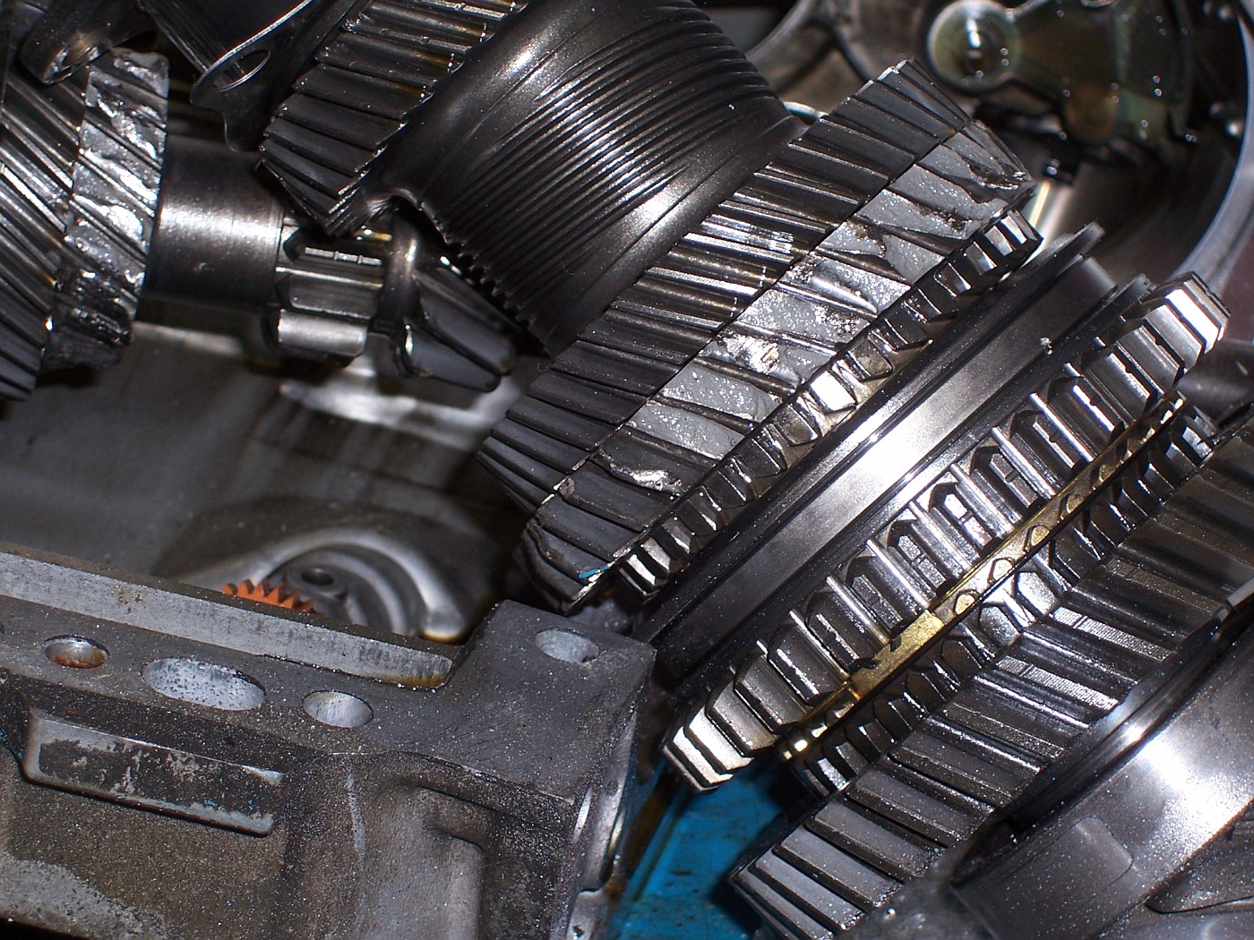

What is the exact cause of failure in these gearboxes? We've done some testing in this area. While many people have promoted case distortion as the cause of the failure (we were probably guilty of promoting this theory very early on)....strain guage testing of the case showed only a small level of distortion even at very high torque levels. While even a small amount of distortion is bad because it misaligns bearings and gears increasing friction and heat generation, it is not the main cause of failure. The main cause of failure is excessive gear tooth separation due to shaft flex. We found that at only 275lb-ft of input torque the gear tooth separation exceeded the recommended engineering limit for a helical gear profile. This separation occurrs because the mechanical leverage provided by the gears also creates a reaction force that wants to push the gears away from each other. The more torque you apply to the gears the more force there is trying to separate them. The input shaft is particularly thin so it can flex quite a bit. When the teeth separate the bending loads on the root of the tooth go up quite a bit. Ultimately the weakest tooth fails and creates a domino effect by wedging between the next set of teeth tearing them free and so on. It is very common to see every tooth on the gear torn clean off.
