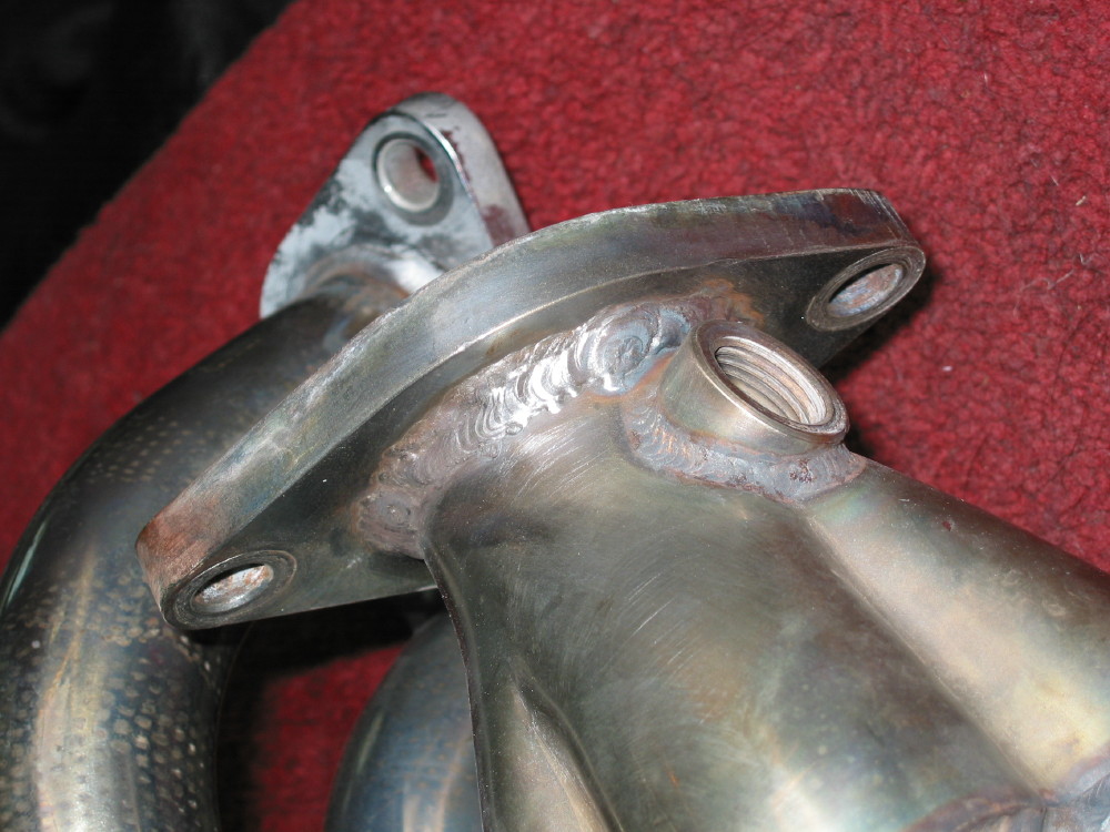

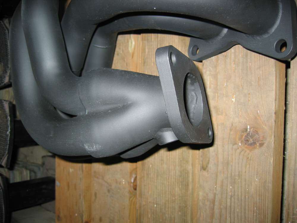

mick_the_ginge a écrit :I wrapped my HKS exhaust headers before I installed them onto the car, including giving them a good coating of exhaust wrap spray. They were installed on the car for about 1 1/2 years which included about 20+ track sessions at PIR.
Recently while upgrading my block I decided to change from wrap to a ceramic heat coat.
The exhaust wrap was in a bad way, it was just falling apart on touch
As you can see the exhaust wrap not only degraded but you can see that it kind of eats into the metal itself. I knew it would do this, but it's amazing to see it up close.
With all the wrap off I also spotted a crack in the welding
Not too much of an issue I had this repaired
I used a local company in Portland Oregon to apply a "high temp" ceramic coating to the headers. I must admit they turned out great
They are coated inside and out. The ceramic coating is very thin but supposed to reduce under hood temps significatly.
Here you can see them installed in the car
What I did not expect was what happened next. First track session and I noticed a smell of burning plastic....... Bugger, the bottom of my radiator fans melted!
As you can see from the above pictures the headers do not touch the radiator, but it is pretty close. 20+ track session with exhaust wrap no issues, one track session with ceramic coating and melted radiator fan.
I am sure for street use the ceramic heat coating is fine, but for the track I am about to re-wrap my headers....
http://forums.nasioc.com/forums/showthr ... t=wrap+bad
